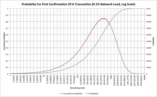

Oh, the irony... I JUST answered the exact same question on Stackoverflow. I'll copy the answer here:
You can imagine two competing miners creating blocks. If a miner doesn't have block N, he'll keep trying to mine that block. If he receives block number N after having mined it, the miner just ignores it, and we have a temporary fork in the blockchain with two branches, and block N+1 will have two different versions. Now what determines which branch survives is basically the branch that is mined faster. An arbitrary consensus rule is that the longer chain is always the correct chain. When a longer chain exists, all miners agree that this chain is the correct one.
The reason why this works, is because the probability of mining a block is wide enough over 10 minutes in Bitcoin (or block time in general).
The following image can be seen as the probability of mining a block over time (in bitcoin).
Probability of mining a block over some time
This is why it's wrong to create blockchains with very short time. Because if the time is very short (like 10 seconds), there will be tons of forks before the blockchain stabilizes.
