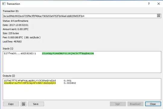

Is that normal to receive more than 6 confirmation in the Bitcoin transaction process? Because the time delay is unbelievable and I received 64 already. But according to blockchain.info, 6 confirmation enough for Bitcoin transaction.
So my question is, how much exactly transactions I have to receive at the end to be sure it's confirmed? Because I sent my Bitcoin in the morning and now the night, but it still did not reach its destination and keep sending confirmations.
https://blockchain.info/tx/0e1ed99dc9932ec6725f9e3f0f406ac7305d53e9752f1b56a61dd8259d53f1b4

Your transaction is confirmed. As Rutger said 1 confirmation is enough, more just means more confidence. You should double-check the addresses you used, it's possible the coins were sent to the wrong place.

  • It's the second day already, but my payment didn't show up, what do I do in that case? Because I checked on the blockchain.info and it looks perfectly fine. Probably there is a place where I might check again? – Alan Dec 06 '17 at 11:21
  • Where did you get the destination address from? Go back to where you got the address from and find it again, and make sure it is the same as the one in your wallet from your screenshot. Also what is the destination? How do you know it didn't arrive? – Adam Millerchip Dec 07 '17 at 15:03
