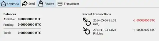

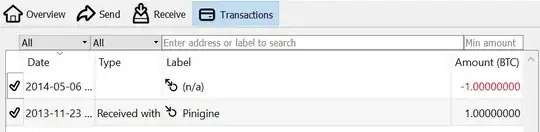

four years ago I've bought 1 BTC, made wallet.dat file and stored in the cloud. Now I wanted to check balance and after syncing on Bitcoin Core found negative transaction with no address.
I did not make second transaction. It has no address. What it is? What the second negative transaction means? Why strange icon? Here's second transaction ID 4837f44e4169f287ca6802c45ceab2dfef36ab7d8ecaa0eaebfa59ea6c76e17b
I have 2 public keys. I've tried to dumpprivkey. After obtaining private keys I've tried to import to one local Bitcoin service (spectrocoin) but after 24 hours nothing changed.
Does it mean that I've lost BTC? Is there anything else I can do? Thank you for your help.

  • No address? Is 17nu7oViEtGCYaYwrKKVGyrs7jkcNwpVf2 your address? Then that BTC is sent to 1NqJgMT4eLPycaD2i7T7xzbd9F9fycWE9u, according to: https://www.blockchain.com/btc/address/17nu7oViEtGCYaYwrKKVGyrs7jkcNwpVf2. So, that's not as mysterious as "no address". Pretty much sure your bitcoin wallet is stolen, perhaps when you carelessly downloaded some malware or viruses that got your information about this. I'm sorry that this has happened but bitcoin transactions are not likely to be reversed, if you have big amount of money, the bank will be a much safer place. – gudako Nov 16 '19 at 10:40

That symbol means that you sent the bitcoin to yourself, i.e. the key for the destination address 1NqJgMT4eLPycaD2i7T7xzbd9F9fycWE9u is also in your wallet. Is your wallet fully synced? Because there was another transaction showing the subsequent spending of the coins, which is not in your screenshot.
It looks like maybe you imported the key for this address after the coins had already been spent from it?

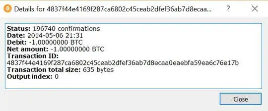

  • Hmm strange. In the transactions window, can you right click on the transaction and "show transaction details"? What is the output? – Adam Millerchip Nov 26 '17 at 07:27
  • Here is all information from the transaction Status: 196738 confirmations Date: 2014-05-06 21:31 Debit: -1.00000000 BTC Net amount: -1.00000000 BTC Transaction ID: 4837f44e4169f287ca6802c45ceab2dfef36ab7d8ecaa0eaebfa59ea6c76e17b Transaction total size: 635 bytes Output index: 0 – tadaspadas Nov 26 '17 at 07:30
  • Sorry I don't know. If you "copy full transaction details", does it say "Payment to yourself"? Your output is slightly different to mine, maybe you could update Bitcoin Core to the latest version (if you've got an older version there's a a database upgrade that will take a long time). But it looks like your BTC was lost or stolen. :-( – Adam Millerchip Nov 26 '17 at 07:36
  • That's the point, there is nothing more like "Payment to yourself". It's full information. I will insert print screen on the main question. I'm using the latest Bitcoin Core version v0.15.1. Thank you for your time. – tadaspadas Nov 26 '17 at 07:39
  • "Copy full transaction details" is slightly different to "show transaction details". It copies a text version of the transaction to the clipboard. There must be a reason for the double arrow symbol, instead of the normal spend symbol. Sorry I couldn't help further, good luck! – Adam Millerchip Nov 26 '17 at 07:42
