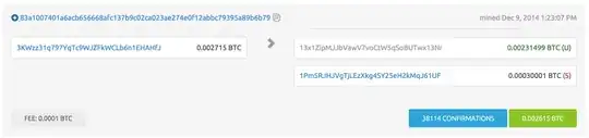

Find the transaction TXID, output index, and amount of the coins you are trying to spend from the block explorer.
  • To get the transaction ID, use the hex code at the top of the transaction box.
  • To get the output index, count the transaction outputs from zero until you find your address. For example, in the transaction shown below, my 13x... address received coins in the first output, which means index zero. If it were in the second output, it would be index 1, etc.
  • To get the amount, make sure you select "BTC" as the website units (in the top right). Then copy the amount from the output where you see your address receiving coins.
So for me, the important information here is:
txid:   83a1007401a6acb656668afc137b9c02ca023ae274e0f12abbc79395a89b6b79
index:  0
amount: 0.00231499
