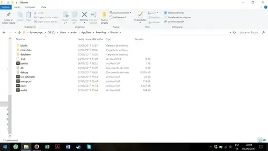

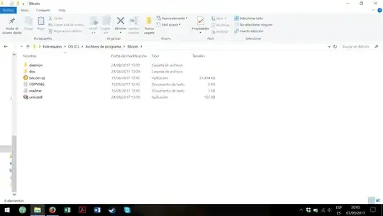

PS: Latter, I have discovered that, in fact, I have three Bitcoin data directories, and suddenly I have doubts about in which of them shall I place my "bitcoin.conf". Is having three directory data how it shall be? And in which of them shall I place my "bitcoin.conf".

  • @AnderAristondo Use the folder from the first picture. Put the bitcoin.conf file there. – Nick ODell Sep 07 '17 at 19:12
