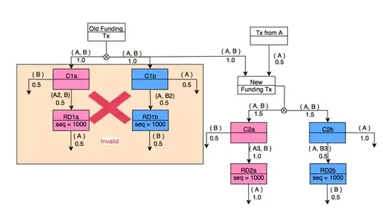

There is a way to increase the capacity of the payment channel. Dynamic Channel Deposit and Withdraw for Lightning Networks The FundCasc Splice-in
If A want to add 0.5 BTC to the channel, he can propose to create a new funding transaction which spent the old funding and another UTXO from A. The new Funding transaction can be created by following steps.
  1. Creating a new Funding Transaction
  2. Creating a pair of new Commitment Transactions (C2a and C2b), containing the corresponding RD2a and RD2b
  3. Signing the new Commitment Transactions
  4. Exchanging signatures for new Commitment Transactions
  5. Signing a new Funding Transaction
  6. Exchanging signatures for the new Funding Transaction
  7. Broadcasting the new Funding Transaction
This proposal (or similar solutions requiring an on-chain transaction) would move funds in the channel back from user B (Bob) to user A (Alice). This is useful, because a channel may have more traffic in one direction, meaning at some point no more transactions can flow in that direction. A single on-chain transaction is preferable to the two that would be required to close and then reopen the channel.

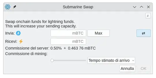

Yes, this is called a submarine swap.
From the glossary of Mastering the Lightning Network:
submarine swap
A submarine swap is a trustless atomic swap between on-chain Bitcoin addresses and off-chain Lightning Network payments. Just as LN payments use HTLCs that make the final claim on funds conditional on the recipient revealing a secret (hash preimage), submarine swaps use the same mechanism to transfer funds across the on-chain/off-chain barrier with minimal trust. Reverse submarine swaps allow swaps in the opposite direction, from an off-chain LN payment to an on-chain Bitcoin address.
Here's what the dialog box for it looks like in Electrum:

  • Using submarine swap it's not possible to change the capacity of the channel. I think by 'adding funds' the original question meant 'increasing the channel capacity'. – OptOut Dec 21 '23 at 22:52
  • @OptOut Yeah, maybe. But it does increase the sending (or receiving) capacity. – Geremia Dec 22 '23 at 00:43
  • The LN part of the submarine swap is a regular incoming LN payment, and a payment does change the balances -- increase the local balance and decrease the remote one --, but it does not affect the channel capacity -- defined by the size of the funding transaction. The channel capacity cannot be changed without changing the funding transaction. – OptOut Dec 23 '23 at 06:10
  • Actually, I've learned that the way to do what I'm asking is called a splice (splice in or splice out). – B T Dec 29 '23 at 21:50
  • @BT Can Electrum do splices? – Geremia Dec 29 '23 at 23:24
    @Geremia I don't believe so. Looks like Eclair, c lightning, and Phoenix wallet have implemented splicing tho. https://bitcoinops.org/en/topics/splicing/ – B T Jan 03 '24 at 19:29
