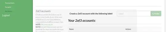

Step 1: Make sure you are using a 2of3 GreenAddress "SubAccount". You can find them in the GreenAddress interface under the heading Accounts in your Settings, as shown in the following screenshot:
Settings -> Accounts -> 2of3 Accounts

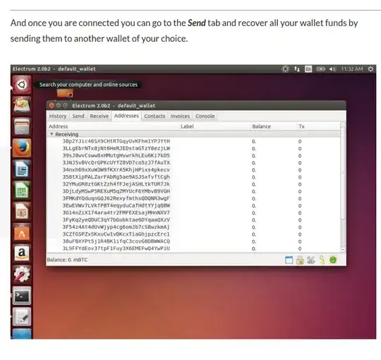

Step 3: Verify that you have the same private keys in the Electrum wallet as exist in the GreenAddress wallet.
You should see your balances in an interface like this:
Step 4: Follow instructions to use Electrum Private keys to get BCH:
https://bitcoinmagazine.com/articles/beginners-guide-claiming-your-bitcoin-cash-and-selling-it/
Don't do the "sending them to another wallet" part just yet /\ Not just yet! /\
Before the send to another wallet ("And once you are connected you can go to the Send tab and recover all your wallet funds by sending them to another wallet of your choice.") step, sweep the private keys into a BCH wallet.
