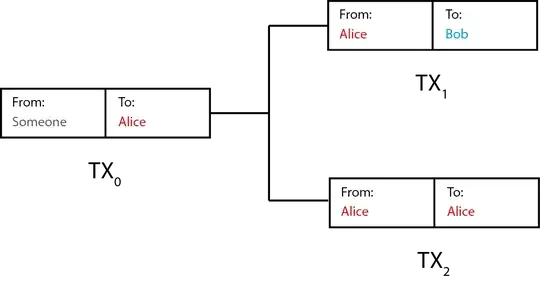

Let me explain you, with a simple example, how double-spending works:
Lets Alice be an attacker trying to double spend some coins. Alice goes to Bob's store to buy some goods. In order to pay for the goods, she create a transaction, TX1, that spends from an UTXO from a previous transaction, TX0, and pays to Bob. Later on, Alice generates a second transaction, TX2, that also spends from TX0 but this time pays back all the money to herself. Down bellow you can see the scenario depicted.
Now, Alice has multiples ways of double-spending the transaction, depending on her hash power and on whether TX1 has been included in the blockchain or not. Since you assumed you have a 51% of the network hash power, we can assume that Alice can mine a block with a greater probability than anyone else, so we will take it for granted, an analyze only the other factor, what happens with TX1.
TX1 not confirmed
If we assume that TX1 is still not confirmed, but it has been broadcast and the nodes are aware of it, Alice can double spend TX1 with TX2 by just including TX2 in the next block she mines. If Bob has accepted the zero-confirmation transaction as a payment and has delivered the good to Alice before the inclusion of TX1 in the blockchain, Alice will obtain both the goods and the double-spent amount.
TX1 confirmed
If TX1 gets confirmed, either because, against the odds, another miner has mined a block in which the transaction was included before Alice mined hers, since Alice has the greater hash rate she can overcome the previous block by continue mining on the top of the previous block. This will create a blockchain fork, and eventually Alice branch will be longer than the other, since her hash rate is bigger. Notice that if Alice does that frequently lots of forks will occur, in which double-spending transaction could be identified, what will undermine the trust on the currency.
Last, being Alice the most powerful miner, she could just include double-spending transaction without forking the chain, by including a TX2 in the same branch than TX1 was included. Notice that this violates the blockchain inclusion rules, since two transactions can not spend from the same source. Therefore, the rest of the network will not accept this block as valid. However, since Alice has the greater hash power she can just keep going and mine over that block. In this case two things can happen, either the trust in the currency is lost since more of the 51% of the hash power is devoted to cheating, or the branch that includes both transactions is just ignored by the rest of the network.

  • What does it mean "will not releayed by the rest of the nodes"? I understand that I need to add a double-spend in the same block in order to succeed, is that correct? – shredding Jun 29 '17 at 18:01
  • A block won't be valid if a transaction spends from the same source (UTXO) than a previous transaction. In the same way, two transactions included in the same block can not spend from the same source, if this happens the block will not be considered valid, since one of the transactions will double spend the other. – sr_gi Jun 29 '17 at 21:25
  • But if this validation exists, how could i overcome it with 51? Wouldnt I just Produce invalid Blocks faster? – shredding Jun 30 '17 at 07:17
    I've updated the answer, maybe now it's clearer. – sr_gi Jun 30 '17 at 08:24
  • It is clearer now. I understand it that if a double spend transaction is in the same block, other miners will understand and reject it. But they won't if they are not in the same blocks.
    Right?
    – shredding Jun 30 '17 at 18:56
    Same block = reject. Different block but same block height = chain fork. Different block but different height (the doble spend is published after) = reject. – sr_gi Jun 30 '17 at 19:02
