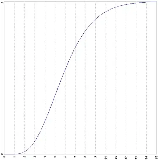

The resulting probability curve looks like this (y-axis is probability and x-axis is λ):
Finally, you were asking for p(x≥6|λ) = 0.99 which turns out to be at about λ ≈ 13.1085. Since the expected time for one block is 10 minutes, this means that in 131 minutes for 99% of the cases at least six blocks will have been found.
