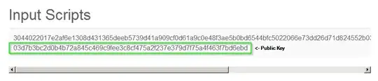

The following is a screenshot of blockchain.info
https://blockchain.info/ja/tx/10857ad56f1695559562af8076aea4ccba625ba79a82f75e5658c0c2fa4336c0
I'm wondering how I can get the source address "1J16FUpZsS6My1FqHXpka5fztAnyFsBPf1".

The scriptSig needed for spending a P2PKH output (that is, an output of a standard address starting with '1...') consists of two parts, namely the signature and the public key. Looking at your example transaction 10857ad56f1695559562af8076aea4ccba625ba79a82f75e5658c0c2fa4336c0, the public key is 03d7b3bc2d0b4b72a845c469c9fee3c8cf475a2f237e379d7f75a4f463f7bd6ebd:
From this you can derive the address by first applying the HASH-160 (where HASH-160(x) = RIPEMD-160(SHA-256(x))), then adding network byte (prefix) and checksum (postfix), and finally converting the whole data into Base58 format. The detailed process of converting a public key to an address is described here: https://en.bitcoin.it/wiki/Technical_background_of_version_1_Bitcoin_addresses
