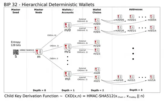

Now, what is that 128number used for? It's used to generate your master private key, master public key and all the keypairs in your wallet. It's nicely detailed here.
The total number of possible extended keypairs is almost 2^512, but the produced keys are only 256 bits long, and offer about half of that in terms of security. Therefore, master keys are not generated directly, but instead from a potentially short seed value.
  • Generate a seed byte sequence S of a chosen length (between 128 and 512 bits; 256 bits is advised) from a (P)RNG.
  • Calculate I = HMAC-SHA512(Key = "Bitcoin seed", Data = S)
  • Split I into two 32-byte sequences, I_L and I_R.
  • Use parse_256(I_L) as master secret key, and I_R as master chain code.
In case I_L is 0 or ≥n, the master key is invalid.
BIP32
