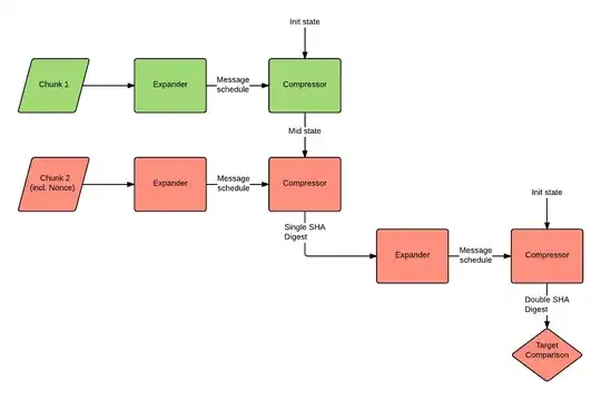

I'm reproducing figures 2 and 3 from the paper below to provide an alternative interpretation.
Fig 2:
Bitcoin block header organization
Fig 3:
Historically, mining is composed of an inner loop (red) and an outer loop (green). Each run through the inner loop, the nonce is incremented. This affects only Chunk 2 and causes all of the blocks in red to be re-evaluated. You can only do this 4 billion times (2^32) before you start creating duplicated results. At that point, the outer loop adjusts the layout of the block data to obtain a new random merkle root field, and you repeat.
In this implementation, you have to do 4 large operations for each inner loop. When changing the merkle root as part of the outer loop, you have to do an additional 2 large operations (in green) on top of the normal 4. However, the author of AsicBoost noticed that when altering the merkle root value, there's a 1:2^32 chance that the contents of Chunk 2 don't change, in which case the output of Chunk 2's expander doesn't change either, so we can skip redoing that computation.
The key at this point is the Birthday Problem. Before we begin mining a block, we can compute several random merkle roots and find collisions (i.e. multiple merkle roots that have the same last 4 bytes, or "tail") without having to evaluate anywhere near 2^32 merkle roots. Additionally, precompute the value labeled "mid state" associated with each of these different merkle roots.
Finally, this allows us an alternative way to generate a new digest without incrementing the nonce: reuse the current Chunk 2 value, choose a new merkle root that collides with the tail currently in use and update the "mid state" with the value associated with that merkle root (which we computed previously). Then re-evaluate all the red blocks except for the Expander attached to Chunk 2, since we haven't altered Chunk 2's value - that's only three large operations instead of the usual four.
