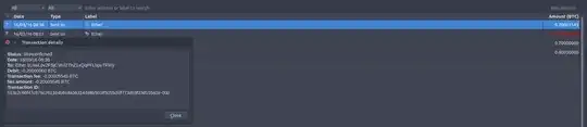

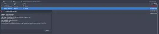

I have two transactions that won't go through. The first one I first one I sent with a zero transaction fee by accident and the second one I second one I sent with a fee of .00022324. Neither is going through. I read this question and one of the answers said that
