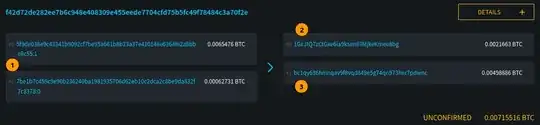

Bitcoin is a distributed system that enables users to receive, store, and send money. Value is transmitted by submitting a payment order to the network called a transaction. Transactions are cryptographically attested statements instructing each network participant to update their copy of the network's ledger of spendable balances which they independently maintain.
All funds in Bitcoin exist in the form of unspent transaction outputs (UTXOs): when users wish to spend bitcoins, their transaction explicitly states which UTXOs are being spent and define how their funds are to be assigned to new UTXOs. UTXOs cannot be partially spent, they are created once and then spent in full by another transaction. (You can think of bitcoins as a substance that is melted and recast every time it's spent.) Only while they are available to be spent, we refer to them as "unspent" transaction outputs, although the blockchain keeps the records of all past transaction outputs. UTXOs are denominated in satoshis, the native unit of the bitcoin protocol. 100,000,000 satoshis are one bitcoin.
Each UTXO is uniquely identified by its outpoint, the combination of the transaction that created it and its position in the transaction's list of outputs. Incidentally, "addresses" are proxies for the locking script the receiver must fulfill to spend the funds later and sending to the same address multiple times will create separate UTXOs.
Screenshot of transaction with two inputs and two outputs from Blockstream.info
For example the transaction f4272d...a70f2e depicted here, (1) spends the two UTXOs 5f9de0...be8c55:1 and 7be1b7...7c8378:0, and reassigns the funds to two new transaction outputs, (2) the zeroth output of the transaction f4272d...a70f2e:0, paying to the addresses 1GxJtQ7...mee8bg, and (3) the first outputs of the transaction f4272d...a70f2e:1, paying to the address bc1qy6...7pdwnc.
As you notice, these mechanics do not align with the common intuition that Bitcoin balances function like bank accounts. We refer to this model of tracking funds as the "UTXO model". You can read a bit more about the benefits of the UTXO model here: UTXO model vs. account/balance model
