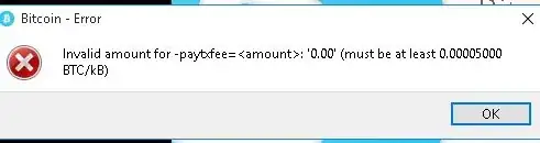

We have setup a bitcoin network using regtest mode and found that there is transaction fee charge on each sending Bitcoin.
Is it possible set the payment fee to zero for each transaction?
We found that there is a setting in the conf file called paytxfee. We have tried to uncomment it, but the client complains that its missing.
We are using ver 0.11. How to get rid of the fee for each transaction?
I enclosed is the error message too.
Pay an optional transaction fee every time you send bitcoins. Transactions with fees are more likely than free transactions to be included in generated blocks, so may be validated sooner.
paytxfee=0.00

Bitcoin-QT will protect you from sending transactions that are very unlikely to ever be included in the blockchain. If you really want to try sending with 0 transaction fee, you will need to use another wallet software or patch and recompile the code.
