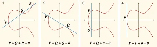

I have a limited understanding of elliptic curve terminology, but if you can bear with me I'd like to ask this question anyway. I'll start with what I understand...
  • You do EC multiplication with the private key to get the public key.
  • EC Multiplication is just EC Addition (done over and over again).
  • EC Multiplication can be achieved through a combination of EC Addition and EC Double (for speed).
From the perspective of the graph:
  • EC Double = draw a tangent on your current point, take the intersect, invert it.
  • EC Addition = draw a line through your current point and a second point, take the intersect, invert it.
EC Double I understand -- you have your current point and you draw a tangent -- no need for any extra points on the curve to get the intersect.
But in EC Addition, if I have my current point, where does the second point on the curve come from when attempting to draw a line across the graph to find the next intersect?

  • This is helpful (as always, Christopher), but I'm still unsure about the visual procedure of Addition on the graph. For example, if I had a private key of 2, my initial thought is to do G+G. Using EC addition, this would involve drawing a line through the curve (starting at G), using a second point to form the slope, and finally hitting a third point (the intersect). But if I'm starting at G, I don't know what is giving me the slope of the line I need to draw. – inersha May 08 '15 at 11:40
  • @inersha G+G is the same as 2*G—it's an EC double operation, so (as you noted in your original question) its a tangent line at G. – Christopher Gurnee May 08 '15 at 15:52

About EC double and addition, scalar multiplcation, from a graphical ans easy point of view.
Addition 2 points: P+R = Q
Draw a line crossing these 2 points, -Q is the 3rd point crossed by the curve. Mathematically, any line crossed EC 3 times. (If P!=0, R!=0 and P!=+/-R) You don't have one point, but 2 when you perform an addition.
Double a point: 2*P = Q
This is a special case of the previous (R=P) Draw a tangent line from P and you -Q is the second point of the line crossed by the line. Mathematically, any tangent line crossed EC once. (If P!=0) You can also view that as two very close points: the common crossing line (the addition line) will become the tangent as the points come closer and closer.
