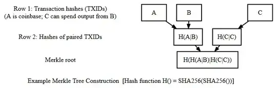

Building the Merkle Tree
The transactions are inserted into the Merkle Tree in the same order they are listed in the block. If a block only contains the Coinbase Transaction, the Coinbase's transaction ID is used as the Merkle Root.
Otherwise, a binary tree is created from the transactions by pairing transaction hashes on the first level, then pairing resulting hashes on each next level until only one hash results, which is then used as the Merkle Root. If there is an odd number of hashes to be paired, the last hash is paired with itself.
Further Reading
The Developer Reference has additional details. The image is from the Developer Reference as well, and hence licensed MIT.
