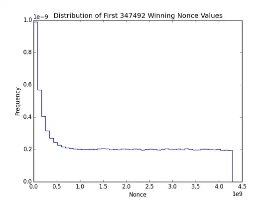

The distribution of wining nonces is skewed toward 0 because this is a selection effect: most everyone starts searching for nonces starting at 0, so the lower nonces are found first, even though there may be also higher nonces that could produce a winning block: winning nonce values distribution

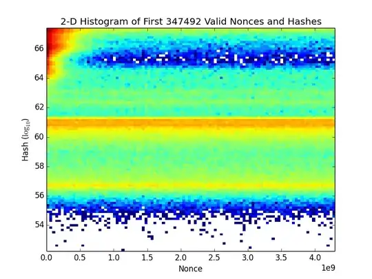

This illustrates very well that the distribution of nonces is uniform: histogram of valid nonces and hashes
source: https://en.bitcoin.it/wiki/Distribution_of_nonces_and_hashes
Thus, +1 in the miner loop is the simplest way of changing the nonce, and it works because the valid nonce distribution is uniform. ASICs often deal with nonces very differently. Also, ASICs can scan the entire nonce range very quickly, so it doesn't really matter where you start looking for a valid nonce.
