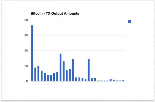

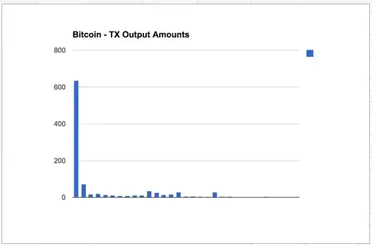

Which, when plotted, gives:
And since the 0-1 outputs make the rest go out of scale, this is a plot without the smallest outputs:
