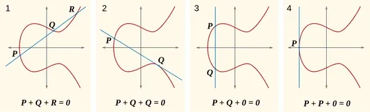

I'm reading up on ECC curves and on many of them I see an illustration that looks like this
What does the comparable curve in Bitcoin look like, or are all curves generally the same?

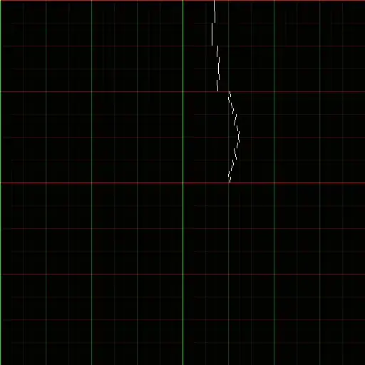

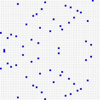

I've tried to plot this curve over a similar but much smaller field, Z28+1. Coordinates extend from -128 to 128.
y² = x³ + 7 over Z257, -128 through 128
Note that even though it may not make sense geometrically anymore, it still has all properties you need. A line (which means, a group of points with equation ay + bx + c = 0) that 'intersects' 2 points of the curve, will intersect a third. Tangent again has no geometric interpretation anymore, but you can still symbolically compute a derivative of the equation in a given point, which will have the property of intersecting the curve in a second point.
To show you what you'd get if this were over the real numbers, here is a plot of the same curve equation for that case. Once with coordinates -128 through 128, once with -8 through 8.

    @pieter you wrote: "that 'intersects' 2 points of the curve, will intersect a third.". Image 3 in the original post seems to show a vertical line intersecting at P + Q ... but seemingly not at a 3rd point. I'm just curious how is the "if 2 then 3" rule applied in ECC. – carl crott Sep 30 '17 at 22:56
    @carlcrott You're right - there is one exception, namely straight vertical lines intersect in only 2 points. This is solved by adding a virtual point 'at infinity' to the curve, which serves as neutral element. The result is a mathematical group. – Pieter Wuille Sep 30 '17 at 22:59

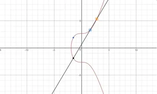

Below an illustration of the secp256k1's elliptic curve y2 = x3 + 7 over the real numbers (plot using www.desmos.com/calculator/ialhd71we3)
secp256k1 plot using www.desmos.com/calculator/ialhd71we3

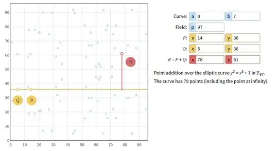

You will find an online opensource tool here https://cdn.rawgit.com/andreacorbellini/ecc/920b29a/interactive/modk-add.html which will help you to plot the graphe and to make addition or scalar multiplication on a EC. E.g plot over F97 with P+Q.
