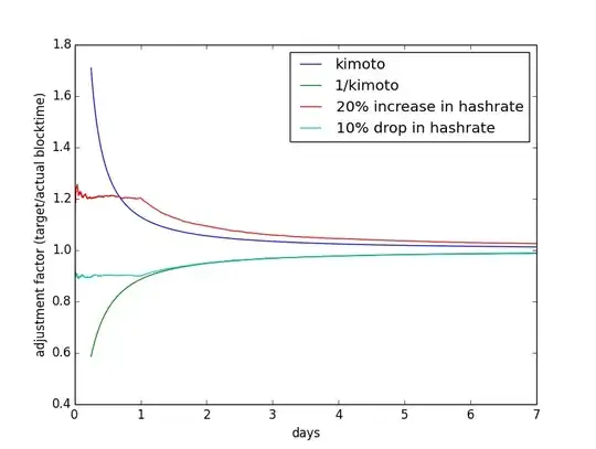

The loop ends whenever the average adjustment factor is larger than the kimoto-value, or smaller than 1/kimoto-value. To understand this look at this python script and an example plot:
from pylab import *
one_day = 1440 / 2.5   # how many 2.5 min blocks per day
nmin = one_day / 4     # PastBlocksMin
nmax = one_day * 7     # PastBlocksMax
x = arange(nmin, nmax)   # PastBlocksMass
# start with 2.5 minute blocktime + some noise
t0 = 2.5 + randn(nmax) / 4
t1 = 2.5 + randn(nmax) / 4
# t0 has 20% more hashrate, so shorter blocktime in the beginning
t0[:one_day] = 2.5 / 1.2 + randn(one_day) / 4
# t1 has higher blocktime in the beginning
t1[:one_day] = 2.5 / 0.9 + randn(one_day) / 4
s = arange(nmax)
adjust0 = (arange(1, nmax + 1) * 2.5 ) / cumsum(t0)
adjust1 = (arange(1, nmax + 1) * 2.5 ) / cumsum(t1)
# the magic function
def kimoto(x):
    return  1 + (0.7084 * pow((double(x)/double(144)), -1.228));
plot(x/one_day, kimoto(x))
plot(x/one_day, 1/kimoto(x))
plot(s/one_day, adjust0)
plot(s/one_day, adjust1)
legend(["kimoto","1/kimoto", "20% increase in hashrate", "10% drop in hashrate"])
xlabel("days")
ylabel("adjustment factor (target/actual blocktime)")
show()
The script produces a figure like this Kimoto gravity well.
It shows two constructed examples when the hashrate increases and when it drops for one day. Best is to play with different settings for a while to get a feel for what is going on.
You see that the lines cross through the Kimoto formula at some point. This is when the algo exits and uses this adjustment factor to compute a new target/difficulty. For large adjustment factors this happens earlier than for the ones closer to one. This is to have a quick adaptation if the hashrate changes a lot, and a slower one if not - then we want a longer period to get a better average. The parameters of the Kimoto formula are adjusted in such a way that one roughly adjusts in one day to a 10% change and in seven days to a 1.2% change. A minimum of 144 blocks determine the new difficulty and at most 4032 (0.25 days or 7 days for a 2.5 minute blocktime).
Summary: the Kimoto gravity well algo has a fancy name and determines the number of blocks which contribute to the evaluation of the new difficulty. It gives fewer blocks for high hashrate changes and is therefore more adaptive.

  • Thank you, this is very helpful. One thing I am not sure I understood: What happens when the minimum of 144 blocks isn't reached or the maximum of 4032 blocks is exceeded. Is the KGW then used or is it then not used? – Murch Feb 16 '14 at 18:18
    The minimum is 144 blocks. So if the adjustment factor is larger than 1+0.7084, then the factor for 144 blocks is taken. At 4032 the algo stops and the average for 4032 is taken no matter what. KGW gives an answer for both boundary cases. – cronos Feb 16 '14 at 20:36
  • Okay, thanks, now I get what you meant with that sentence. Excellent answer, thank you very much. – Murch Feb 16 '14 at 20:59
