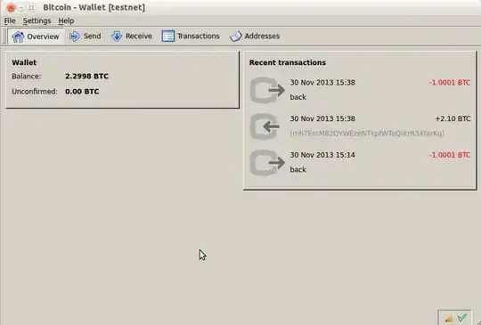

first install the software(bitcoin-qt) by following the steps:
sudo apt-add-repository ppa:luke-jr/bitcoincore
sudo apt-get update
sudo apt-get install bitcoin-qt
run:
bitcoin-qt -testnet
since testnet
is huge, as @Janus Troelsen suggest, there is a lighter version(signet
bitcoin-qt -signet
click on the Receive
button in the screenshot to get the address
go to link http://tpfaucet.appspot.com/ and give the address
to get testnet bitcoins
