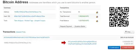

I see that blockchain.info shows that I sent bitcoins to another address as well! Can anyone explain why it shows that I sent bitcoins (about $30) to the address 1NTyaVoNrQYx2PA5ce7bVmqA6jfmSSkvxU on blockchain.info? I definitely did not send to that address...

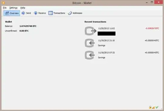

This is my Bitcoin-QT client window. It shows the correct transaction amount.

This is because you did not have a coin that exactly matched the amount you wanted to send to your friend. So bitcoin had to split a larger coin into 2 coins... 1 with the amount to send to your friend and the rest as "change" to send back to you. The address you don't recognize is a new address that was created for the change, and it's in your wallet.

  • Awesome answer, but what do you mean "the new address is in my wallet"? Are you saying I have two addresses now? If someone sent to that new address, would it end up in my wallet? – Ci3 Nov 20 '13 at 19:48
  • Yes, you have 2 addresses. Bitcoin added 1 for you. People can send to either one and it will end up in your wallet. – RentFree Nov 20 '13 at 19:57
