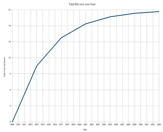

A pre-defined schedule limits the total number of bitcoins so that they gradually approach a total of 21 million (ignoring those that have been lost through deleted or misplaced wallet files). The limit of 21 million bitcoins is "hard-wired" in to the protocol, and there will never be more bitcoins than this:
The Schedule on which Bitcoins are released into the economy through being rewarded to miners
eMansipater
  • 14,456
  • 50
  • 79
    Note that there are some assumptions built into the timing and unless the protocol is changed, they will actually be mined a bit earlier than this chart suggests. – David Schwartz Aug 31 '11 at 00:00
    Or later--if the value drops precipitously and difficulty takes a while to get low enough again. But the graph is a good rough approximation. – eMansipater Aug 31 '11 at 00:02
    I think that's very unlikely. Even if there are a few precipitous drops, I think that will be outweighed by the overall trend of increasing hashing power (and they'll be followed be precipitous drops in difficulty). But, yes, that is possible. – David Schwartz Aug 31 '11 at 00:04

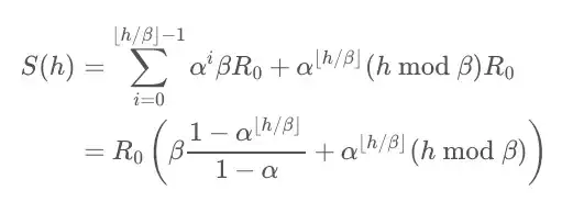

I wrote a detailed analysis of the supply and inflation in Bitcoin, for those who are interested in the math behind it. Below is a formula expressing Bitcoin supply as a function of block height:
where S is supply, h is block height, alpha=1/2, beta=210,000, R_0=50 and topless square braces denote the floor function.
Taking its limit as h-> infinity, we arrive at the same result provided by @Artefact2.
