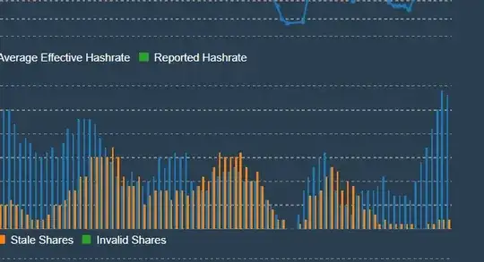

I was also facing the same problem that time. This problem was due to my usb device (modem) which give internet access to my rig, when I remove that usb modem and connect the rig with my phone via USB than i saw a huge change in the mining performance.
My stale share which came down from 30% to almost 3%. My modem was connected directly to motherboard and it may be it got disturbance signal from all my gpus. It was network problem and make sure the device which you use for giving internet to rig should be kept far from it.
In given picture you can see how much stale shares drops from left to right .
