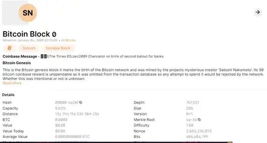

if you convert this little piece of sh*t from hex to ascii you will get this "E" (im not sure if its important or not). now as you can see at coinbase message it has the "E" before the message
Screenshot of genesis block
5468652054696d65732030332f4a616e2f32303039204368616e63656c6c6f72206f6e206272696e6b206f66207365636f6e64206261696c6f757420666f722062616e6b73:
message : The Times 03/Jan/2009 Chancellor on brink of second bailout for banks
so when you combine all the str? idk, you will get this
(nbits length) + (hex value of nbits in little_endian) + (the f*ck you want to call this) + (message)
04ffff001d0104455468652054696d65732030332f4a616e2f32303039204368616e63656c6c6f72206f6e206272696e6b206f66207365636f6e64206261696c6f757420666f722062616e6b73
