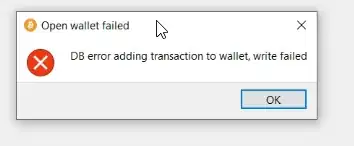

I've loaded Bitcoin Core 22.0.0 and have completely synced the blockchain. No wallets loaded or new wallets created at this point. Then I tried to restore the old-wallet.dat and after about 20+ minutes, I get this popup error:
Open wallet failed: DB error adding transaction to wallet, write failed
And the db.log in the AppData\Roaming\..\old-wallet\ shows
file wallet.dat has LSN 1/76511, past end of log at 1/476
Commonly caused by moving a database from one database environment
to another without clearing the database LSNs, or by removing all of
the log files from a database environment
[..... these 4 lines repeat 48 times]

So here are my questions:
-> Is it possible using Bitcoin Core to get this old-wallet.dat file to import properly and addresses show up in the GUI.
-> Is there a way to rebuild the wallet.dat file? It seems to crash as newer transactions may have additional columns that the older database doesn't have.
-> is there another way to force import the addresses/keys? (in Bitcoin core or like using a different wallet) to where I can sweep/access the bitcoins?
-> why was 3rd party tool able to read .dat file (after decrypting) but Bitcoin Core cannot? Or why isn't there a simply way to do this?
