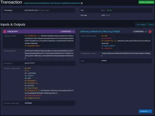

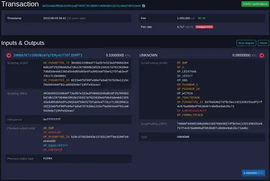

These transactions may break some block explorers in the sense that some block explorers may only have support for standard scripts and would not properly display bare outputs. It seems to me that modern block explorers no longer suffer from that: Mempool.space shows the entire output sc appears to doript just fine
e.g. mempool.space shows the output script in the preceding transaction…
enter image description here … and the spending transaction just fine.
In case "breaking block explorers" was understood as a privacy benefit, this transaction is not more private. In Bitcoin, transactions do not spend funds from addresses: addresses merely specify the conditions under which funds can be spent, but each input must specify exactly which transaction output it is spending. The preceding transaction a601…0e0c created a single output a601…0e0c:0 with the mentioned bare output script that could be spent by the owner of that script, and the first input of 54fa…814f explicitly spent that a601…0e0c:0, to create another transaction output 54fa…814f:0 that can be spent by the receiver in control of the address 1GMaxweLLbo8mdXvnnC19Wt2wigiYUKgEB. I.e. every UTXO is uniquely identifiable and the transaction graph is public information. The absence of an address has no privacy benefit.
