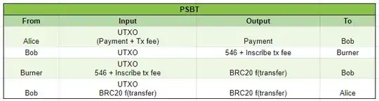

I try to put this into a Psbt:
  1. Alice make payment to purchase an amount of BRC-20 from Bob
  2. Bob request to inscribe a transfer of BRC-20 by using Burner account
  3. Burner inscribe the transfer of BRC-20 and transfer to Bob
  4. Bob transfer the BRC-20 to Alice
Bob create the Psbt and Burner account, and signed. Then send to Alice to make payment and sign. Alice topup on price to cover all following transaction's network fee.
