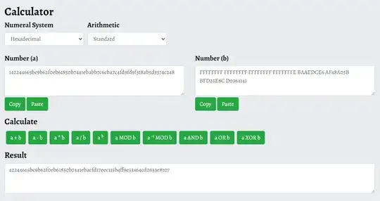

Next, following BIP32, the right 32 bytes represent the child's chain key, and to get the child's private key, the next thing we need to do is add the left half of the result (4eb98f36d3bd9c27c2d74ae497e2dba29e3af8365b1de8fc29dd2f39b8111017) and the parent's private key (f36ab72ee8ddc6c9288a3a26dc5f1009198bd37169dfb6ddc93b7c237b63b231). Also, the MOD operation should be performed on the obtained result. The secp256k1 elliptic curve order is used for this. Order of the secp256k1 elliptic curve is FFFFFFFF FFFFFFFF FFFFFFFF FFFFFFFE BAAEDCE6 AF48A03B BFD25E8C D0364141. Next two pictures show how to do this using this online tool.
So, the 85th hardened child private key and its chain code are:
CHILD PRIVATE KEY: 42244665bc9b62f0eb61850b7441ebacfd17eec115b4ff9e33464cd0633e8107
CHILD CHAIN CODE: 841d3b7767023d0d985618d4a6b8d466aaac220155cb1fb18739836a86f2c223
