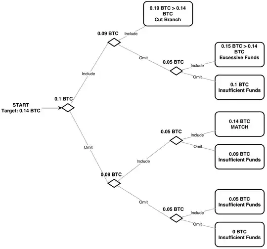

Let’s assume we have three UTXOs with effective values of 0.1 ₿, 0.09 ₿, and 0.05 ₿. We are searching for an input set that raises 0.14 ₿. Our search would look like this:
Example search graph from the Master thesis
via Erhardt: An Evaluation of Coin Selection Strategies (2016) [PDF]
  1. {0.1}: We have insufficient funds and continue.
  2. {0.1, 0.09}: We select 0.1 ₿, then select 0.09  for a total of 0.19 ₿. We have overshot above the target window. We backtrack.
  3. {0.1, 0.09, 0.05}: We deselect 0.09 ₿, then select 0.05 ₿ for a total of 0.15 ₿. We have overshot above the target window and backtrack.
    {0.1, 0.09, 0.05}: The omission branch of 0.05 ₿ leaves us with insufficient funds. We have completely searched the subtree that starts by selecting the 0.1 UTXO and continue by skipping the 0.1 ₿ UTXO.
  4. {0.1, 0.09}: We have insufficient funds and continue.
  5. {0.1, 0.09, 0.05}: With a total of 0.14 ₿, we have found an input set that produces a changeless transaction. This is our new best input set.
    {0.1, 0.09, 0.05}: The omission branch of 0.05 ₿ has insufficient funds.
    {0.1, 0.09}: The omission branch of 0.09 ₿ also has at most 0.05 ₿, so we cannot find any solution there.
For a wallet with a larger UTXO pool, this search would likely yield multiple solutions. In that case, we would compare the input set candidates on basis of the waste metric and keep the input set with the best (i.e. lowest) waste score.
