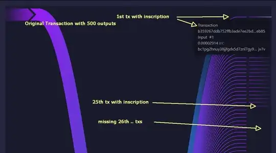

The blockchain has your original transaction 369a...76a7 with 500 outputs plus change.
flow diagram
As shown above, the blockchain also has 25 of your intended 500 subsequent transactions. Those 25 have inscriptions in their inputs (consuming 25 of the 500 outputs of your original transaction 369a...76a7):

So I guess you should submit the remaining 475 transactions, possibly in groups of 25 if your tools have that restriction.
In this situation I would replicate the situation in testnet, not in mainnet, and then test out creating the remaining transactions one at a time on testnet. I would only use mainnet after being completely satisfied with the results in testnet.
As I commented, I am not an expert in Ordinals, Inscriptions or BRC-20. Do this entirely at your own risk.
