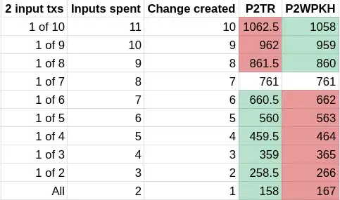

The below table shows the total weight of transactions under the assumption that most of them are single-input and creating change, created using either P2TR or P2WPKH outputs, and one of X transactions having a two inputs instead of one:
Table that compares total weights for
If only one out of seven transactions uses two inputs and you always create change, you’ll be able to save up to 1.5% by sticking to P2WPKH.
If 1 out of 6 transactions has at least two inputs or if you can sometimes avoid creating change, your total transaction weight would end up being lower if you use P2TR.

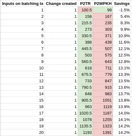

Batching
Whenever you use more inputs than you send outputs to yourself (e.g. when you make big transactions for batching payments, consolidation transactions, the payments you receive are smaller than the ones you make), or you’re able to avoid change altogether, it will be cheaper to use P2TR:
