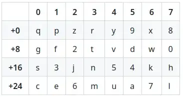

We use addresses to represent certain standard output templates. An address encodes the output script in a form that is protected by a checksum and presented in a more human-consumable shape. In this specific case, we are looking at a native segwit v0 witness program with 32 bytes payload, or a Pay to Witness Script Hash (P2WSH) output.
The address is calculated from the output script by taking the human-readable part (“hrp”) and the data of the output script (witness version and witness program) to calculate a checksum. The address is then assembled by concatenating:
  • the hrp bc for Bitcoin mainnet
  • the separator 1
  • the data encoded using bech32 (see table below)
  • the checksum encoded using bech32
bech32 translation table via BIP173
Vice versa, a sender can decode the address they get from the receiver by checking the address string for validity, removing the checksum, and decoding the data part to extract the output script. Based on the version, they can check whether the witness program has the correct form (esp. length).
If you’re looking to implement bech32, I would suggest to check out one of the eight reference implementations and the test vectors on the BIP. Note that addresses for native segwit version 1+ use the bech32m encoding defined in BIP350 instead of bech32 (BIP173). Although, the only difference is that bech32m modifies the checksum constant.
