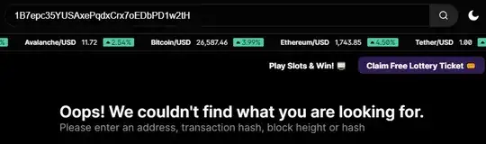

On the other hand, when I change a single character in such an address or enter random digits and letters that visually resemble a BTC address (including length) but were not generated using the mentioned lib/service, blockchain.com states that "Nothing found."
screenshot3_madeup
How do the service distinguishes between real and made-up addresses, in this case?

Bitcoin transactions on-chain do not have addresses. They have scripts as output. In theory, pretty much any script is legal on-chain (ignoring standardness rules), including many unspendable ones.
To make things more convenient to work with for humans, certain standard scripts (in particular, P2PKH, P2SH, P2WPKH, P2WSH, and P2TR ones) have a human-readable notation associated with them, known as addresses (in base58, bech32, or bech32m format). These addresses include a checksum to protect against typos; a truncated double-SHA256 one for base58, a BCH one for bech32(m). This checksum, like the address itself, does not exist on-chain.
Software that interacts with the blockchain will generate/show scripts in address form (which means adding the checksum), and typically only accept entering scripts in address form (which means verifying the checksum in it). That holds for:
  • Wallets, when creating a new receive address.
  • Block explorers, when showing the scripts in transactions.
  • Wallets, when sending.
So how does the block explorer know the address it shows is valid?
  • If it's something you search for, it takes the address you input, parses it, verifies its checksum, converts it to a script, and searches its database for it. Even when nothing is found, the script is valid, so it can show that there are no results. If the checksum was invalid, it would instead tell you that the address is invalid.
  • If it's something found in a block or transaction, the explorer converts the scripts to their address form (including correct checksum), and shows you that.
In neither case is it certain that anyone has the corresponding key, unless there are also spends of the funds received to the address in question. In particular, one can compute scripts that look like a given string in address form easily, if one does not care about finding the corresponding private key.
