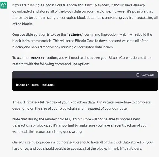

** Note: I asked this question of ChatGPT and it provided the following response. I don't know if it is correct or not, but I'm going to try it.
-1
