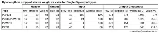

Yes, your formula is correct for small counts of inputs and outputs of a single output-script type. Note that Bitcoin uses transaction weight (and/or vsize) since segwit, but transaction weight is forward-compatible to transaction sizes of non-segwit transactions.
tx_weight = overhead_weight + (input_weight × input_count) + (output_weight × output_count)
If you are only using P2PKH (legacy single-sig outputs) that is
tx_vsize = 10 vB + (148 vB × input_count) + (34 vB × output_count)
If you have different output types, you will need to account for the different weights of outputs: enter image description here
Also, if your input count or output count exceeds 254, you have to increase the size of the overhead because the respective counter will weigh 3 vB instead 1 vB.
