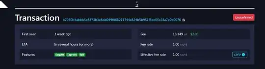

I deleted mempool.dat and did CPFP for stuck transaction after restarting core and it's worked, tx id: tx id: b7030b3abbb5e8873b3c8dd049f068211744c824b5b951f5ee65c23a7a0d0076
