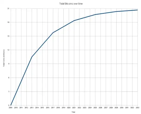

One new block is created every 10 minutes on average. The mining difficulty is adjusted to keep this rate constant
The mining reward is halved every 210,000 blocks, about every four years.
These two facts alone determine the amount of spendable Bitcoin available at any moment in time.
The result is that the total amount of spendable Bitcoin converges in a completely predictable way towards 21 million. It cannot exceed that.
Total Bitcoins over time
(Source: Insti, Creative Commons Attribution 3.0)
As the mining reward approaches zero, miners will be rewarded through transaction fees alone.
