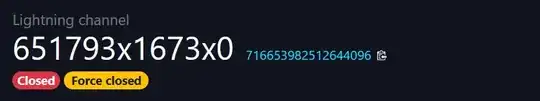

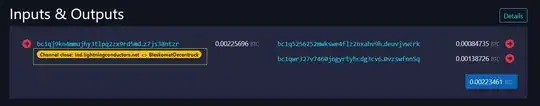

This seems to be a pattern with lot of force closed channels tx.
