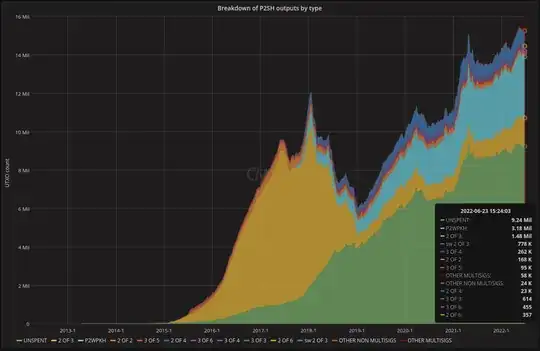

For P2SH UTXOs it gets more complicated. We know the redeemscripts only for about a third of the UTXOs per this P2SH breakdown:
enter image description here via https://txstats.com/dashboard/db/p2sh-repartition-by-type
  • unknown: 9.24M
  • P2WPKH: 3.18M (91 vB)
  • 2-of-3: 1.48M (297 vB)
  • wrapped 2-of-3: 778K (139.5 vB)
  • various non-segwit multisigs¹: 607K
  • other non-multisig: 24K
¹ 3-of-4, 2-of-2 and 3-of-5 are the most common known output type after the explicitly listed. I'm assuming that "other multisigs" and "other non-multisigs" are smaller than 3-of-4, but it seems reasonable to estimate all the remaining non-segwit multisigs and non-multisigs as approximately the average of 2-of-2, 3-of-4, and 3-of-5: 360 B
Known outputs: 3.18M × 91 vB + 1.48M × 297 B + 778K × 139.5 vB + 631K × 360 B = 1 064 631 000 vB
Assuming the average input virtualsize of 175.5 vB applies also to the unknown P2SH UTXOs: 9.24M × 175.4 vB = 1 620 696 000 vB
