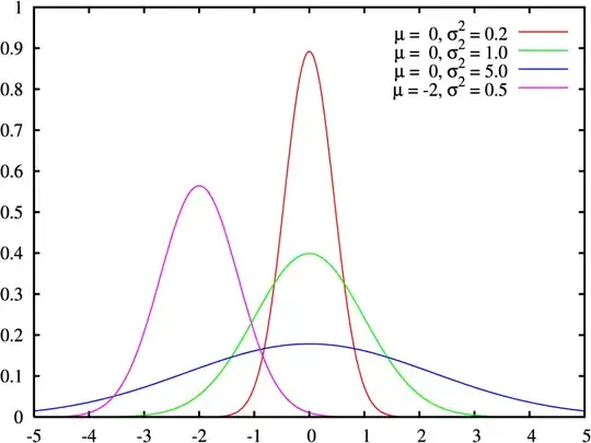

I mean, supposedly this distribution should follow the Gaussian function, or am I wrong?
normal distribution

we can assume that wallets are uniformly distributed on 2^136.75 gaps.
I'm no statistician but, to me, a uniform distribution does not imply fixed length gaps. I suspect the ratio can only inform you of the probability that a search of a smaller space will yield an expected number of results.
