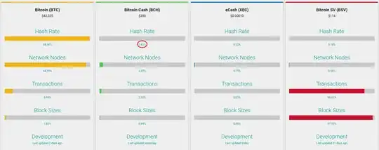

If we take a look beyond Bitcoin, we'll notice that e.g. some minority-hashrate forkcoins of Bitcoin have chosen to introduce rolling checkpoints. For example in BCH, nodes do not permit reorganizing further than ten blocks. While Bitcoin's central security assumption is that the majority of the hashrate is honest (as in, not colluding to attack), BCH cannot rely on that assumption given that is only attracting about 0.63% of the SHA-256d hashrate.
Statistics on the hashrate distribution across a few SHA-256d based blockchains
via coin.dance
