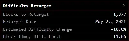

Difficulty adjustment is one of the critical features of Bitcoin that Satoshi implemented. It basically means - adjusting the bitcoin block time to ~ 10 minutes as programmed.
Think of it this way - if suddenly more miners join in then there would be more hash power and blocks would be mined quicker then before (less then 10 minutes) - the difficulty adjustment, that happens every 2016 blocks (~2 weeks) would raise the difficulty of mining making if harder to find the block eventually raising the block time back to ~10 mins.
The same thing applies if there are miners leaving (shutting of their miners) - then there would be less hashpower resulting in slower block times (more then 10 minutes) so the difficulty would lower making it easier for the remaining miners to find the block eventually lowering the block time to ~ 10 minutes.
Ex: When the difficulty is 6, then what I can know from that number?
Difficulty is measured in % of change, the current difficulty change is estimated at -10%, meaning it will be 10% easier to mine a block in the next difficulty epoch (each epoch is 2016 blocks)
check it out here https://bitcoin.clarkmoody.com/dashboard/ enter image description here
