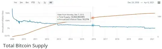

  2. Bitcoinvisuals has the supply chart and you can move the cursor over the chart to know supply at any given date in past.
supply
