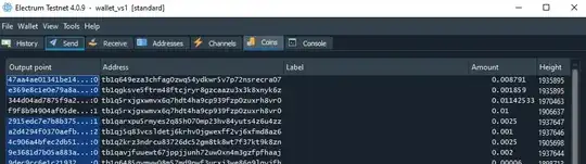

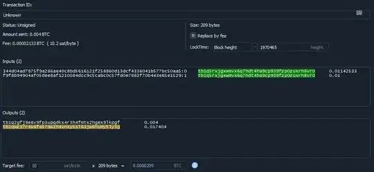

Coin selection algorithm in Electrum favours privacy so its using all the UTXOs associated with the address as explained by leevancleef. To reproduce this I followed the below steps in Electrum 4.0.9:
  1. Send some amount to one of the addresses from coins tab.
  2. Freeze other coins
  3. Try to create a transaction paying amount less than both coins available for address: tb1q5rxjgxwmvx6q7hdt4ha9cp939fzp0zuxrh8vr0
electrum-coins
electrum-transaction
