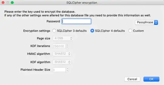

I backed up my wallet.dat using the command as mentioned in the api ref:
bitcoin-cli -rpcport=18332 -rpcuser=user -rpcpassword=password backupwallet "/bitcoin/backup.dat"
I would like to view the backed-up db file using 'DB browser for sqlite' (or any other sqlite browser). However when opening the db file it prompts for the password / key to decrypt the wallet file.
Which password / key is it referring to? When creating the backup I didnt specify any password or key..

  • Is there any reason you don't use db_dump from the Berkeley db-utils package? I've used that under Windows-10 by using WSL (Ubuntu) - It can definitely dump an unencrypted Bitcoin wallet.dat file. I imagine it might even be easier to install and use db-utils under OSX - if that's your operating system. – RedGrittyBrick Mar 08 '21 at 13:49
  • Well the wallet.dat is from an Ubuntu server running Bitcoin-core that I am then opening on the OSX machine after the backup.. I hadn't known about the Berkeley db-utils package, can the db_dump util be safely run against a live running node? Or could it be run against the already backed up wallet.dat file? – leo_cape Mar 08 '21 at 14:05
  • I ran it against a backed up wallet.dat - not one that was being actively used. – RedGrittyBrick Mar 08 '21 at 14:10
  • Thanks @RedGrittyBrick works well, didn't know this package existed! I guess the wallet.dat is just made up of a 'main' db/schema and the keys inside it, I was hoping to see visually what else was contained in it, but it looks like only keys and some meta – leo_cape Mar 08 '21 at 14:12
  • OK I'll post my comment as an answer – RedGrittyBrick Mar 08 '21 at 14:19
  • wallets only use SQLite in limited circumstances. To make an SQLite wallet run Bitcoin Core version v0.21 or v22.0 then create a new descriptor wallet; https://github.com/bitcoin/bitcoin/blob/9a42b5e/doc/release-notes/release-notes-0.21.0.md#sqlite-database-backend – Dan Nov 22 '21 at 18:59

  • New wallets are using SQLite, since the OP mentioned it they probably using that so i doubt a Berkeley DB tool would work for their use case – Antoine Poinsot Mar 08 '21 at 14:31
  • @darosier, AIUI Bitcoin core uses different libraries for the wallet file than for the other files. https://github.com/bitcoin/bitcoin/issues/20160 – RedGrittyBrick Mar 08 '21 at 14:33
  • I ran db_dump on the already backed up wallet.dat (sqlite) and it did dump some interesting info ie. I the name of the db 'main' and the keys. I guess thats pretty much all there is in the wallet..? Was hoping to see a visual depiction of the db. I haven't marked this answer as correct yet as I still would like to know which password / key the browser is wanting – leo_cape Mar 08 '21 at 14:35
  • @leo: I'd guess it needs the password used to encrypt the key values (if you protected the wallet.dat with a password) But I don't know if Bitcoin Core uses some global encryption provided by the DB library or whether it applies its own encryption to the relevant value contents only (I thought it was the latter but don't actually know for sure). I surmise SQlite might be asking for a global DB password which doesn't apply, might be doing so because it is confused or might be doing so because it wants you to decide if one is needed. I'm not familiar with SQlite – RedGrittyBrick Mar 08 '21 at 14:43
