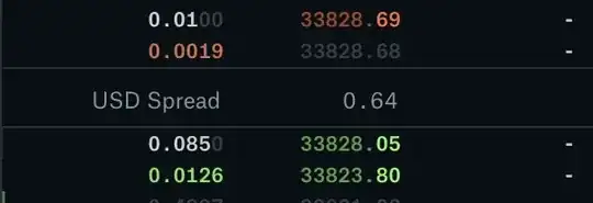

TLDR: The highest bidder on the exchange will get it.
One of the main jobs of an exchange is to match sellers with buyers. The exchange will help users sell for the highest price possible, and buy for the lowest price possible. If the price you want is lower than the highest bidder (buyer), the exchange will tell the buyer, "hey, we found someone that wants to sell you bitcoin at your price!". The buyer does not know that you were willing to sell for 4000.
Noone will be lucky. All reputable exchanges have several people wanting to buy at a price higher than 4000 when the current price is 40 000.
You can figure out the price you're going going to sell for if you take a look in the orderbook. There you can see people wanting to both buy and sell bitcoin for different prices. In the picture, green orders are buyers, and red orders are sellers. The price you're going to get when you sell bitcoin is the top green one. orderbook example
You can try it for yourself! Add a limit sell order with 4000 as the price. Depending on the exchange it will tell you that by placing the order, 100% of the order will be filled. The final price is not going to be 4000, but probably very close to 33 828.

  • Yes, pretty much impossible! It's only possible in order books with very low liquidity. As long as you use a reputable exchange and trade bitcoin, you won't find that.
    No, it does not make sense to do that. Every single buyer willing to pay more than 4k will get filled before you.
    – Bjørn Olav Jalborg Feb 02 '21 at 07:41
    Yes! Very close to 33828 using my image an example. – Bjørn Olav Jalborg Feb 02 '21 at 07:42
