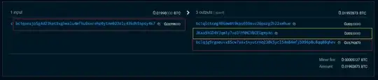

Maybe its a change address. You can read about change addresses in the below links:
What does change address mean inside Electrum wallet?
What all the addresses are in my Electrum wallet?
tx-screenshot

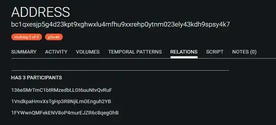

I am not sure why change address is starting with "3" which can be a p2sh-segwit address because input address bc1qxesjp5g4d23kpt9xghwxlu4mfhu9xxrehp0ytnm023ely43kdh9spsy4k7 is most likely an address from 2 of 3 multisig wallet with p2wsh addresses.
multisig
  • yeah, but I cannot find it in my ADDRESSES tab :( – digitalzoomstudio Dec 07 '20 at 18:40
  • Then its not an address from your wallet and you added it in the outputs while creating transaction. Or if this is a wallet used by 3 people and 2 of them signed the transaction, then maybe other person added it in outputs so bc1qxesjp5g4d23kpt9xghwxlu4mfhu9xxrehp0ytnm023ely43kdh9spsy4k7 is input, bc1qlctcpg486aw0t9kps659evc26pszg2h22xmhue is crypto.com address, bc1qjg9rgaeuvx85cw7ssvtnyutrnq230k5ycl54m84mfj5096p0c8qq00qhev is change address and 3Kxa9XGD4VJqm1y7vd31YNNCVBCEUgmyAn UNKNOWN ADDRESS added by you or other cosigner. –  Dec 07 '20 at 18:44
  • seems it might have been added from my Electrum Software – digitalzoomstudio Dec 07 '20 at 22:58
  • https://api.trustedcoin.com/#/electrum-help – digitalzoomstudio Dec 07 '20 at 22:58
