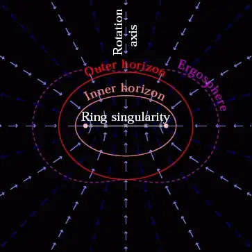

However, Hamilton and Lisle (2008) found that the Doran chart of Kerr spacetime can be interpreted as a six-dimensional "Lorentz river" characterized not only by a velocity but also a twist. This really quite different from the acoustic fluid analogy, as the 'river' does not spiral inwards, but rather has an intrinsic twist that rotates infalling objects. Still, it is interesting in its own right.
River model of Kerr black hole, by A. Hamilton
Image by Andrew Hamilton. (Twist not shown.)
